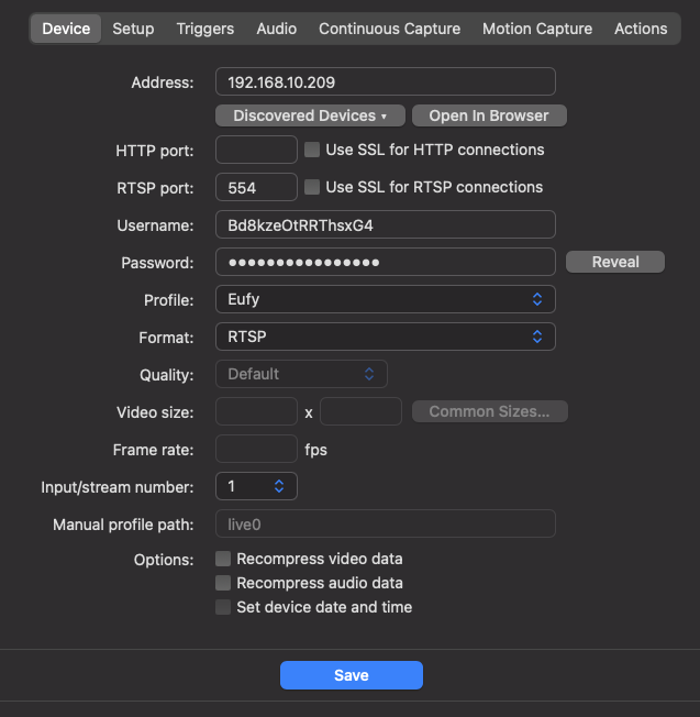

Anyone added the Eufy S350 to SS? I'm following the same "RTSP" procedure as for other Eufy cams but no luck with these.

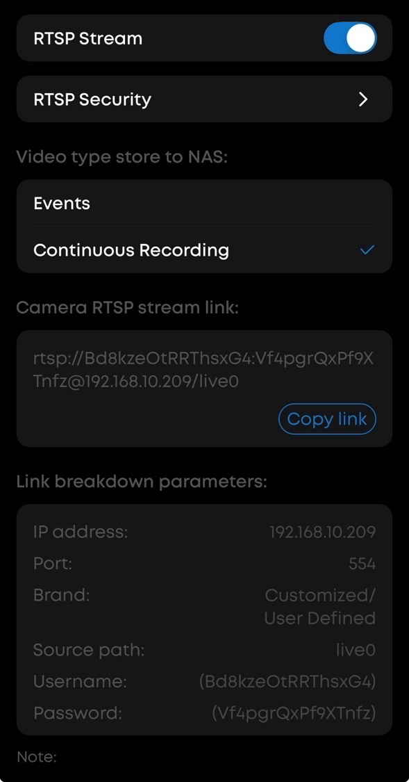

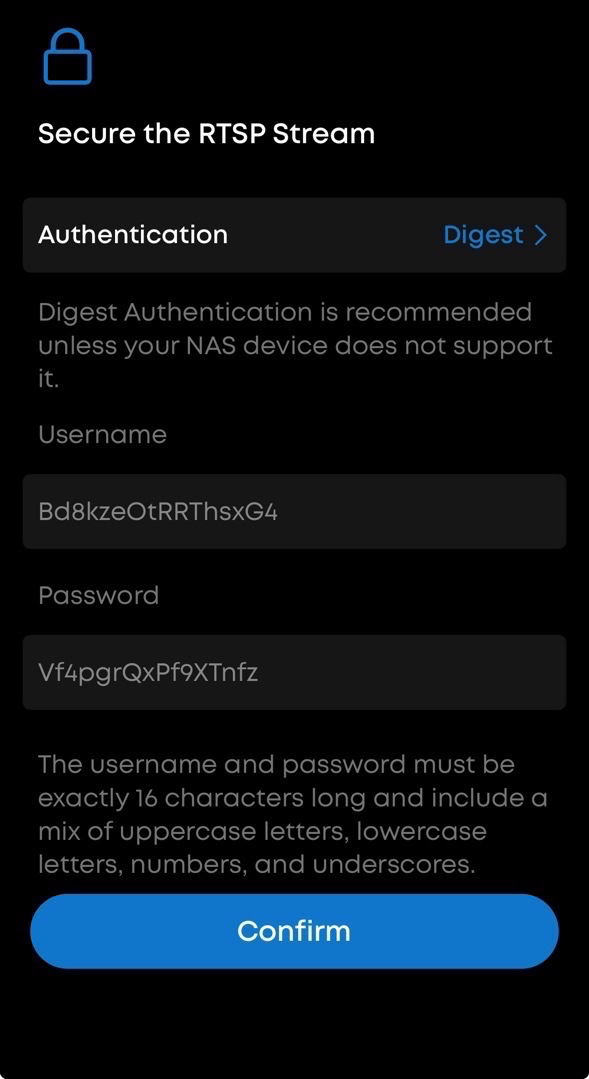

- RTSP has to be specifically enabled in the camera using the Eufy app

I have 3 Eufy cameras in my SecuritySpy system - None of them work with the eufy profile. You have to use a manual configuration - Camera IP address in the address box - 8554 in the RTSP port box, and /live0 in the manual profile path box. Everything else blank. Hope this helps!!
