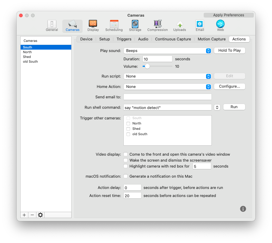

Recently updated from Monterey to Ventura. Play sound on motion trigger no longer working. Is there something in Ventura that requires a setting.

My apologies. Should have mentioned a tick against all of these. [Hold to play]: get plenty of sound. Same for [run].
Curious! Was working prior to update.

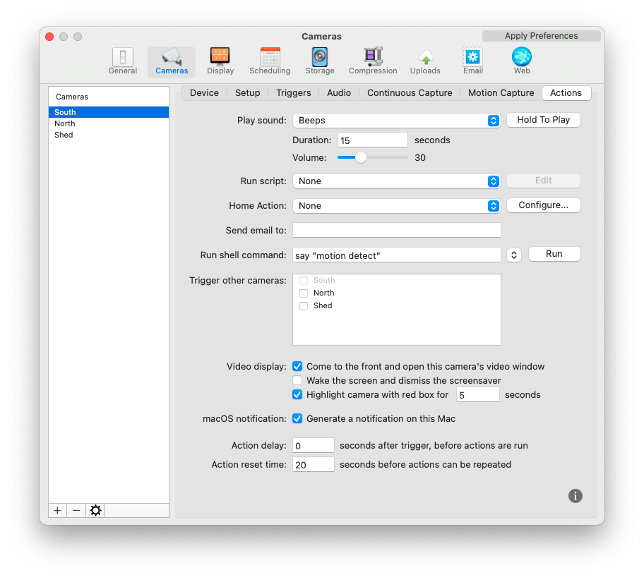

So, set up a completely new South (not using Duplicate or Copy all) and all is well. Go figure!
In your screenshot above, the "M" indicator is orange/red, but the "A" indicator is grey, indicating it is unarmed. M stands for Motion Capture while A stands for Actions, so I think this explains the problem. In any case, I'm glad you got it working by recreating the camera (when you do this, both M and A are on the "Armed 24/7" schedule by default).
