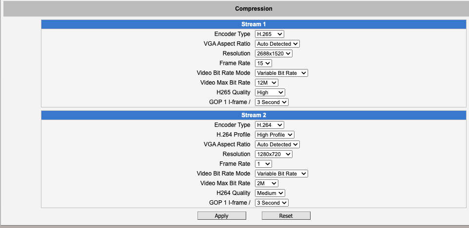

  • Didnt know you could set a stream number to Zero, it only shows me a drop down menu, 1- 128. I've attached a few screen shots below covering your questions. Appreciate your help, First camera we've run across in over 10yrs with SS that we couldn't get to work on any of our various SS installs.

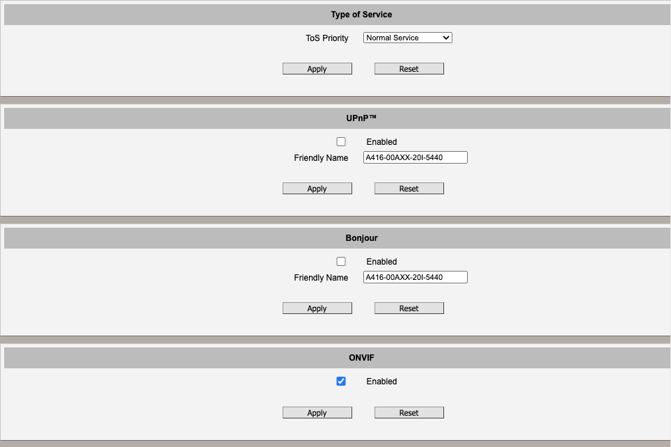

    OnVIF can be enabled or disabled, No other choices. Its enabled.
    I've tried all three different stream settings and also H.264 even though we generally use H.265 when the camera supports it.

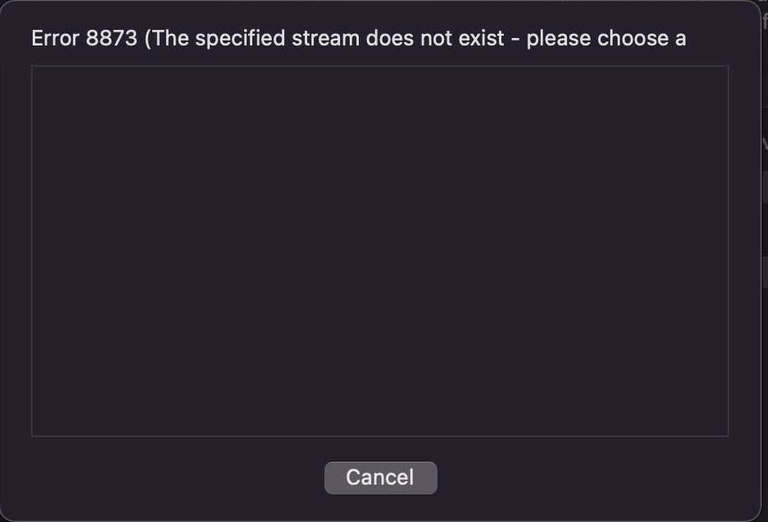

    This is the error msg when using H.265 and clicking auto-detect stream.

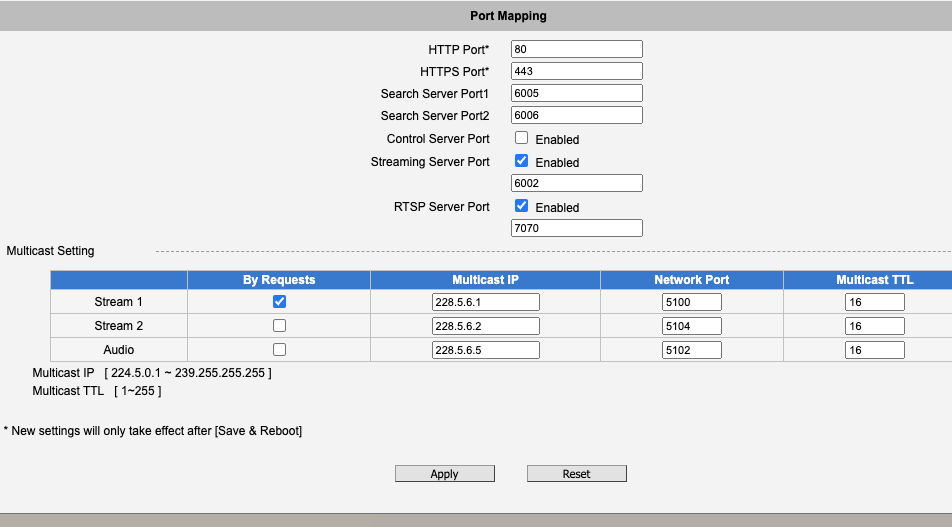

    However, it's clear that the camera is not making any streams available. See if you can locate anywhere in the camera's settings where you can add/remove ONVIF streams. This won't be under the "Port Mapping" settings that you posted, this will be somewhere else. It's possible that the camera has no streams set up by default - it's rare, but we've seen this a few times with other cameras.
    The other thing I notice from your screenshots is that the camera is using a non-standard RTSP port of 7070. This could be the thing that prevented the ACTi profile from working previously. I would recommend changing this setting in the camera to 554 (the standard RTSP port), applying the setting, and then trying the ACTi profile again in SecuritySpy (with the "RTSP port" box empty so that SecuritySpy also uses the standard RTSP port of 554). Does this work?

    That was It!! RTSP port needed to be 554. Thank you so much. I've been banging my head against this wall for over a month.
    For whatever reason it was defaulted to 7070. Upgraded the Camera firmware with no luck, then I defaulted it, again no luck. Changed that RTSP port to 554 and its now working perfectly. Acti Setting working great.
