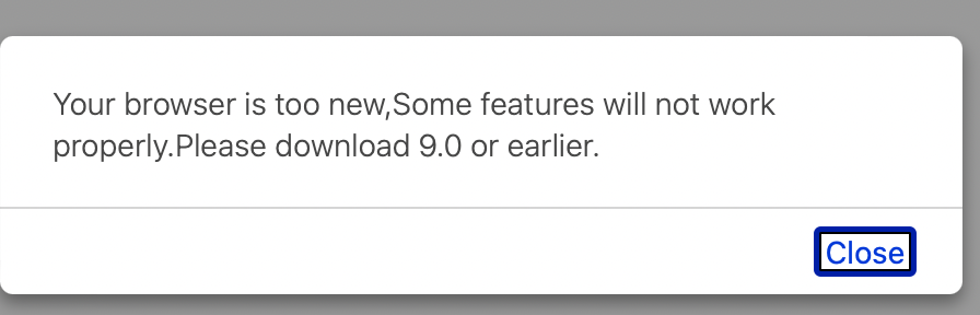

  • Hi Ben,
    I haven't been able to run the web interface since I get this error in Safari and similar problem with other browsers:
    It wants to install a plugin which I'm skeptical of and can't get working anyway.

  • Since this camera apparently doesn't support ONVIF out of the box, and its web interface doesn't work on modern browsers, my recommendation here would be to return it and instead use a camera that is included in our list of supported cameras. Sorry I can't be of more help with this, but since it's basically impossible to configure the camera I don't really know what else to suggest here.

  • edited July 23
    Success! I was able to get into the camera's browser interface using the Internet Explorer mode of Edge. A plugin called NetSurveillance provides the interface with an overwhelming amount of options. I'm not exactly sure what it does but checking the "Onvif check" checkbox seems to have done the trick.
    I also changed the SecuritySpy ONVIF port setting to 8899 since that was the default in the camera so that actually may have been the fix. Leaving it blank gives an ONVIF error.
    In any event, I can now use the ONVIF profile and PTZ control works, including presets and patrol!
