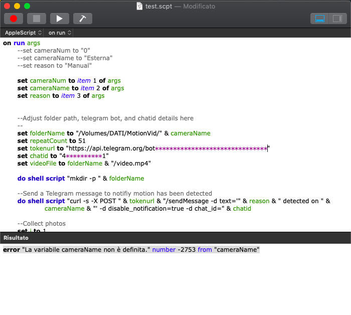

  • Hi Paul, thanks for sharing what I've been trying to do for some time and yet to no avail.
    Could you help me look for the error?
    I currently work in security spy with only one cam (num 0) and her name is "External". While compiling the script I find an error. Can you help me soon?
  • paul2020
    edited March 2024
    Hi @Niko ,
    If you're running the script outside of security spy you need to define the cameraNum/Name/reason variables so that it knows which ones to use. If running from security spy these values are supplied by the software and picked up via the "args" variable.
    e.g. The top few lines should look like this if you are running the script by itself. Remember to swap the commented out lines back around after testing.
    on run args
       set cameraNum to "0"
       set cameraName to "Esterna"
       set reason to "Manual"
    --set cameraNum to item 1 of args
    --set cameraName to item 2 of args
    --set reason to item 3 of ar
