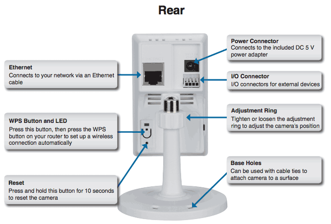

Hi Ryan, I've checked and unfortunately none of the D-Link camera models you mention have digital input ports. What you'd need is a camera with a port on the back where you can connect a switch (or PIR sensor, which acts as a switch controlled by movement), then SecuritySpy can monitor this port and use this information to trigger recording and actions.
An example of a camera that has this is the DCS-2130 - from the camera's user manual:
See the "I/O Connector" block on the right. Are you looking to add another camera? We could suggest some models if that would be helpful.
