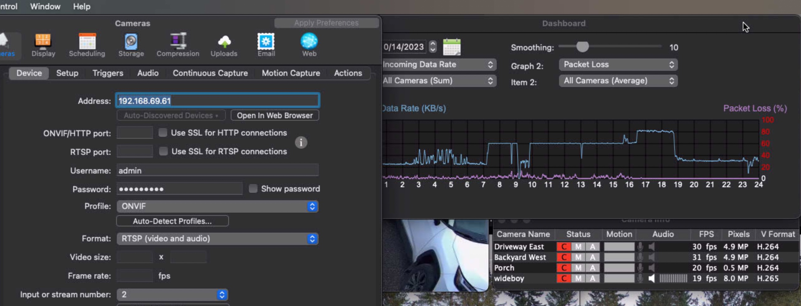

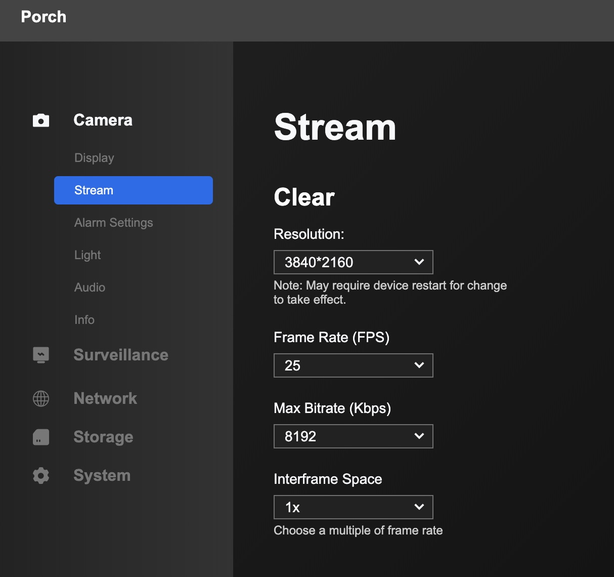

  • I just got one of these cameras and am having the same issues with dropouts. I’ve been troubleshooting with the ONVIF, Reolink, and custom profiles. Reolink profile with h.265 is the most stable. I thought it might be my cheap PoE switch, perhaps drawing more power when night vision is on but the camera works fine from the Reolink app (used for testing..) and web app. Did you ever find a setting that resolved the dropouts? I have 6 other Reolink cameras (410s I think) that work great with SS. I’ve also tried adjusting quality profiles from clear to fluent - no change.

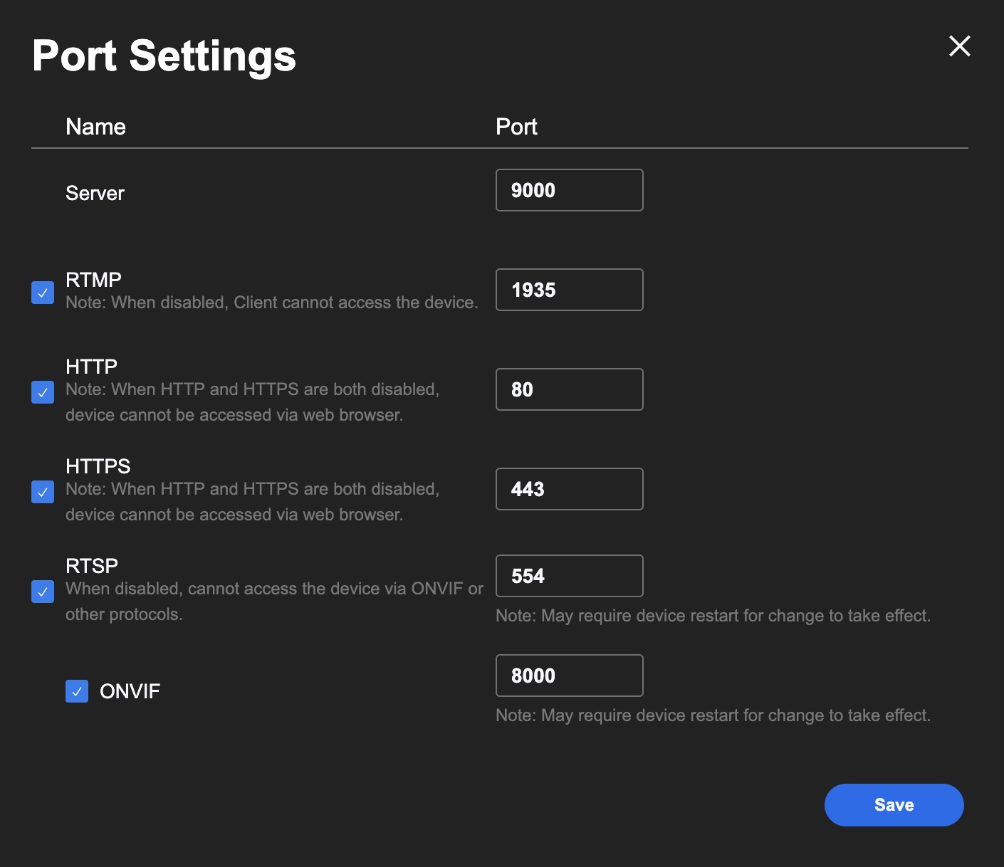

  • These are the settings I used to get this camera stable. SS: ONVIF, RTSP. In Setup -> Advanced -> Enable allow invalid SSL certs, Enable use PTZ numeric value if you want PTZ to work through SS. On the camera I enabled all protocols after I saw some HTTP requests failing in burp suite. My technical summary is Reolink is doing some goofy shit with RTSP, I'm not entirely sure what the actual fix was. But this is what worked for me. I'm hoping I can get h.265 stable next.
