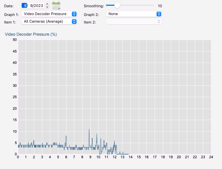

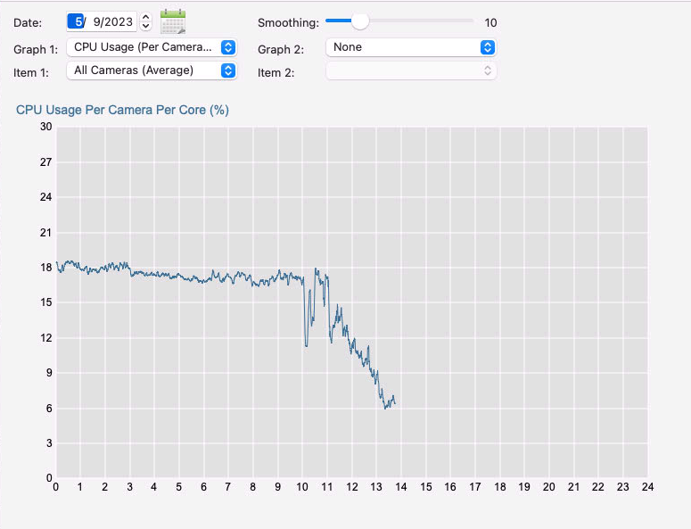

    A bit more hackery today before fixing this the "right" way with Ben... I wrote a short shell script that would do sort of what I want. It's sub-optimal but... it does work. I've only applied it to four or five cameras (all 2k/4k) - you can see in the graphs where I applied the script and I have four or five more to go - and my CPU and GPU numbers have dropped significantly. This editor leaves a lot to be desired for pasting shell script... (disclaimer: I actually wrote this quite a while ago and was very sleep deprived at the time so it may have other flaws that I haven't noticed)
    #!/bin/bash
    # usage: ./secondary-activate <camera-number>
    # jtodd@loligo.com
    # v0.1 2023-05-09
    # SecuritySpy (www.bensoftware.com) video surveillance add-on script
    # Goal: to reduce the CPU and GPU usage on very busy or older gear
    #    that can’t keep up with a large number of high-resolution
    #    cameras. Use just the low-resolution streams for examination
    #    and then turn the high-res streams on temporarily when
    #    something interesting happens.
    # This activates Motion Detection 24/7 for a camera, triggers a motion event,
    # then turns off motion detection. To be used as an “Action” event by low-res
    # camera streams which can then “wake up” the higher-resolution camera for
    # recording of the event. This removes the load from the CPU from parsing
    # high resolution camera data, since low-res cameras are usually sufficient
    # to trigger on motion events.
    # Just create clones of your high-res cameras, change the stream from ‘1’ to
    # ‘2’ (which is almost always the low-res stream) and add this action into the
    # new low-res camera as a shell command, using the high-res camera number
    # as the argument. So “/usr/local/bin/secondary-activate 12” is the command
    # you’d use on your low-res camera, if your identical high-res camera is
    # number 12.
    # Then turn off scheduled or 24/7 status for continuous/motion/actions on
    # the high-res camera but leave everything else the same.
    # I would suggest the “Action delay” be set to zero and “Action rest time”
    # set to 1 on the the low-res camera.
    # Make sure to have “suspend motion detection when not needed” and
    # “suspend video decoding when not needed” checked in the General preference.
    # This script is very dumb; it could be the case that it gets “stacked” in
    # a busy environment, where it’s running several times based on events detected
    # on the low-resolution camera, which will cause unexpected results or lost
    # events.
    # Get the authid by using the user/pass combination you created in the “Web”
    # preferences. Run this command to get the authid: “echo -n user:password | base64”
    authid="aeRvZ3Q6Zm93XmPyMBIz"
    # Wake up the high-res camera specified - set Motion Detection status to 24/7
    curl -X GET "http://127.0.0.1:8000/setSchedule?cameraNum=$1&mode=M&schedule=1&auth=$authid"
    # Delay a moment to let this take effect (needed? Not sure.)
    sleep .5
    # Trigger a motion detection event on the high-res camera we just activated
    curl -X GET "http://127.0.0.1:8000/triggermd?cameraNum=$1&auth=$authid"
    # Give a healthy wait before we shut the camera back down. I should probably
    # be more clever here and check to see if there are any motion events happening
    # on the camera before turn off the Motion Detection schedule, so we don’t shut
    # the camera off during interesting things.
    sleep 30
    # Turn off Motion Detection schedule to be “None” instead of 24/7
    curl -X GET "http://127.0.0.1:8000/setSchedule?cameraNum=$1&mode=M&schedule=0&auth=$authid"
  • This script above is not a "bandwidth" savings tool - it is a processor savings tool. It will actually increase bandwidth, since each camera will send both a low-resolution and high resolution stream of data to the SS server. However, only the low-res one will be decoded and examined for motion events. If you want to use it for a bandwidth savings tool, you could possibly re-write it to actually activate/de-activate the whole high-resolution camera entirely, which would (I assume) stop the video stream from even being fetched. It would take some time for the high-res stream to be activated, connect, get a key frame, etc. but for people who are using SS over really poor low-bandwidth links or using bandwidth that is very expensive (satellite) then maybe it would be a reasonable solution for cutting back on bitrates by 80-90%. Just modify the script to use the "camEnabledCheck" value described in the API. (https://www.bensoftware.com/securityspy/web-server-spec.html)
  • Just an update on my script - this is working surprisingly well. I have converted all my high-resolution cameras to use this model, and now on my 12 core Intel Mac Mini, six of the cores are entirely idle, and the six cores that are active are averaging only around 35% usage, and I suspect that is mostly due to six older low-res cameras which are ancient and still using software decoding for JPEG streams. The GPU is at around 20%. This is with 38 total streams. Decode pressure is almost none. (All my streams are VBR, if you're wondering why the data rates are a bit odd.)
    Note that many of the "Dec" column entries are "..." meaning (I think) that there is no decoding happening. These are the high-resolution streams. Each high-resolution stream has a corresponding low-resolution stream just below it from the same camera. All the streams (high and low resolution) are active and being pulled in by SS, but only the low-resolution streams are being decoded and examined. When a motion detection event is triggered by the low-resolution stream, the script (as an action) is fired, causing motion detection to be enabled on the high-resolution stream, and a motion detection even to be forced on the high-resolution stream. Then the high-resolution stream chews up CPU while being decoded. After 30 seconds, motion detection is turned off on the high-resolution stream, and we go back to where we were.
    This has led to a drastic reduction in my CPU/GPU usage.
