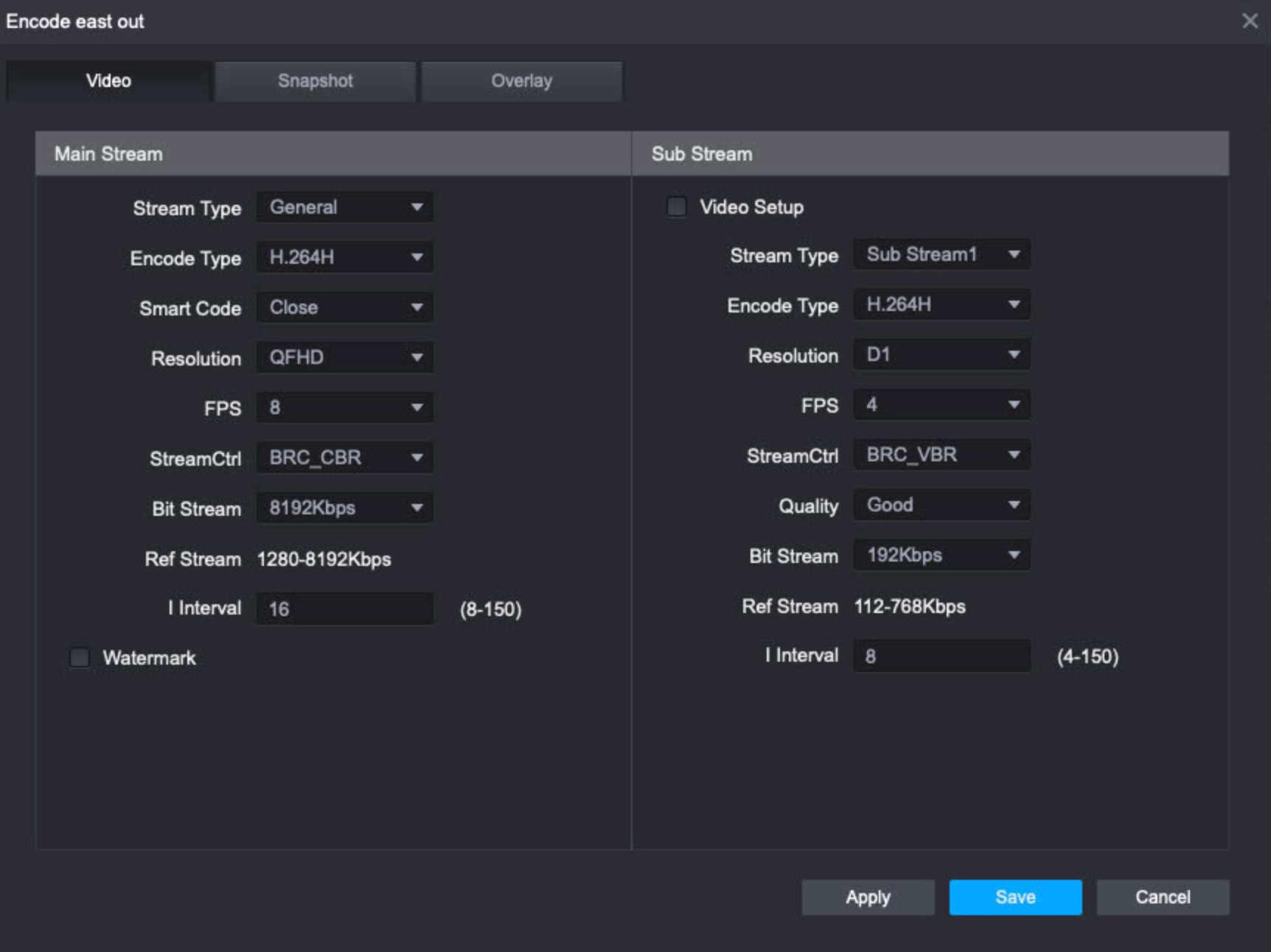

  • can u post a screenshot of the Dahua web config- video section?
  • I've never used web setup, I have Dahua's SmartPSS app, so it's dozens of separate config panels. But I think it's about the same as web setup. Here's the main camera panel. Are there other settings you are wondering about?
  • what's smart code??
  • I have no idea. Tried to look it up once but the Chinese to English translation was so poor it was no explanation at all. It seemed to be related to some kind of automatic choice of resolution by the firmware.
    The only other choice besides the default "Close" is "Open". I left it at the default "Close" on all the cameras.

    Finally, there are some compression artefacts, so boosting the data rate may help a bit. I would recommend VBR encoding, with a high quality setting.
    If you don't get significant improvement by adjusting the encoding and cleaning the lens, I would recommend replacing this with a new 4K camera. The image quality has improved for these Dahua cameras over the years, so you will get much better image quality from an entry-level 4K camera purchased now than one purchased three years old. Or, ideally, get one with a better lens (auto-focus and auto-iris) as this can improve the image quality significantly.
    "Smart Codec" is a Dahua-specific scheme where the camera can adjust certain parameters such as frame rate and key frame interval in order to reduce the data rate. This can lower quality and produce unexpected results, so I would recommend leaving this turned off.
