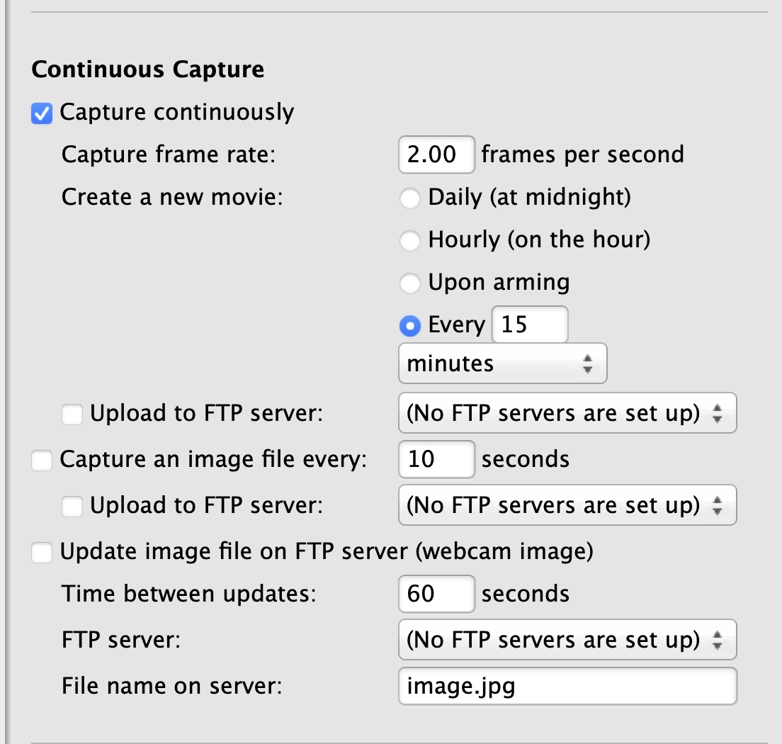

For one of my cameras (INQMEGAPRO using NETCAT profile) the movie files are being broken into 1-2 second segments rather than 15 minutes as I've specified. Occasionally I get slightly longer files but it always reverts to 1-2 seconds. Is there any camera characteristic or error state that might account for this?

Hi Dave, for this camera, have you enabled the option at Preferences > Cameras > Device > Advanced Device Options Detect and adjust for video stream format changes?
This is the main thing I can think of that could cause this issue. SecuritySpy has to start a new recording whenever the camera changes its video stream format, so if this happens often then you will get lots of short files.

I was able to solve it but the advanced option you noted didn't make a difference. No idea why but it started working when I selected the option to recompress the video. I was hoping this option would also help with Monocle/Alexa access but no such luck. Recording normal length files is much more important though so I'm a happy camper! 😀
