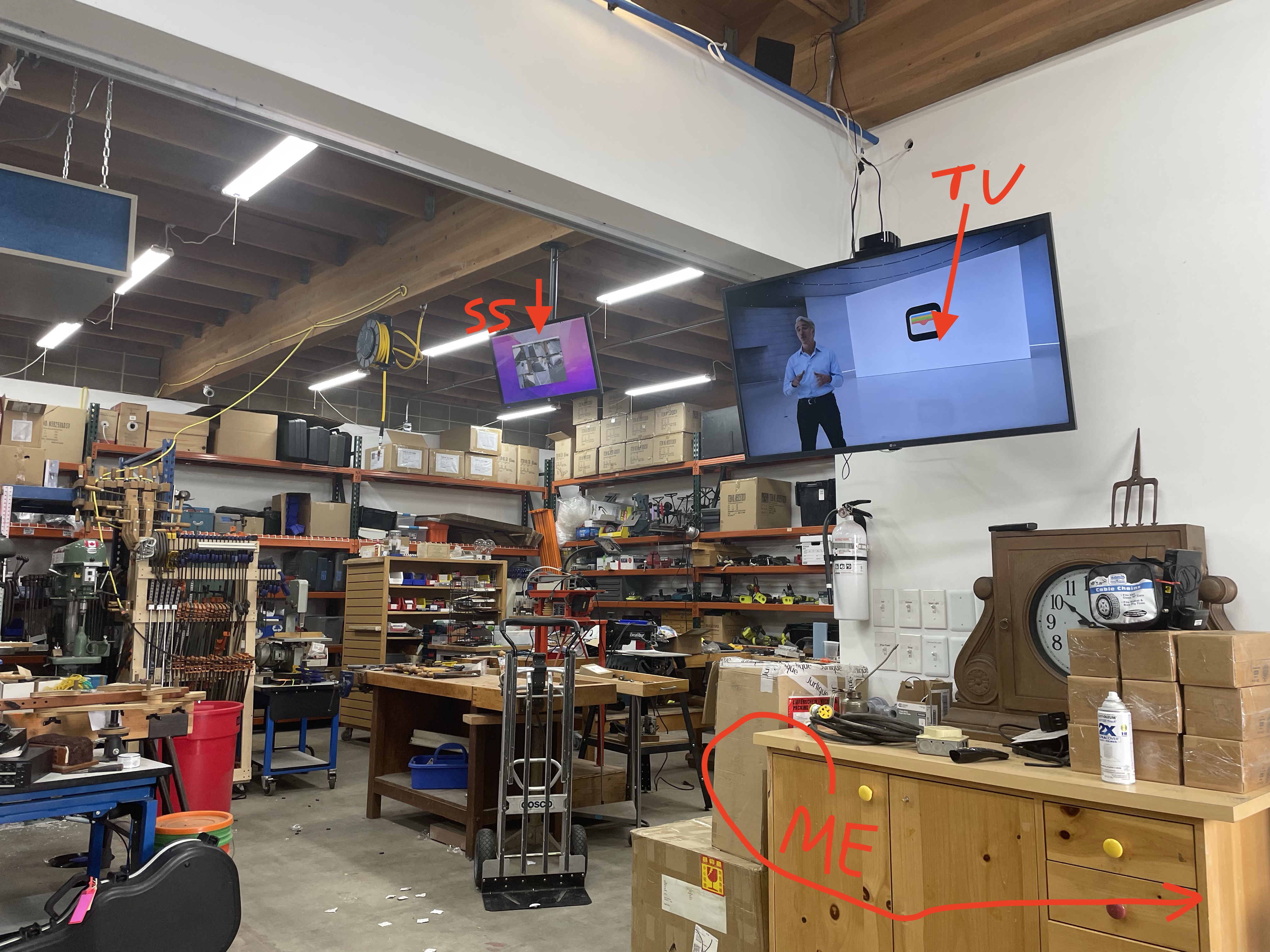

I've mounted a large screen in the middle of my warehouse, and run an HDMI extender out of my mini to it. I have the main SS window moved over to this screen, with my main cameras I want to check on during the day rotating through their displays - and this all essentially works fine. Except that when the main screen on the mini goes to sleep, the feed to the remote monitor stops. I can let click the SS app on the main monitor menu bar and choose my group, and it comes back up - so thats no a huge problem, but if there were a way to keep that active on the secondary screen it would be nicer.
Since the main SS window fills this remote monitor, and its a fair distance (and over my shoulder) from my primary monitor, I set my mouse cursor to XXL so I could see where it was to select the menus for SS. Worked, but have discovered there is a memory problem on the Mac when using large cursors - so I've had to kill that - which means when I want to access the preferences, or anything else, I need to kinda guess where the mouse is, walk over and look up at the screen and go back to the desk and try to get the mouse moved to where I need it and try clicking and moving til I get the menu item I want - a pita -so, Is there a way to add a menu option to the SS icon in the menu bar that would open the prefs window, or even better, the entire SS main menu, on the primary monitor when the main display is on the secondary monitor? Or, is there a way to select camera groups and automatically send them to the secondary display, while keeping the app and its menu choices on the main display?

    I don't want mirroring, I have a very large monitor on my work desk, and it can have windows up on it monitoring my 3d printer, or shipping software, or even a video game (don't tell my wife!) - the other monitor is about 15 ft away, hanging from the ceiling so when I hear car crashes, gun shots, screams, or lots of barking, I can just glance up and see what the natives are up to outside.
    Interestingly, when I move the SS window to the second display, and hit cmd-F, it opens full screen on both monitors, and I can't figure out how to close just one, without hitting cmd-F again to minimize them.
    This isn't a major thing, just an inconvenience, but it seems like it would be fun to be able to "cast" a screen to a specific monitor while controlling views and options from the main screen -
