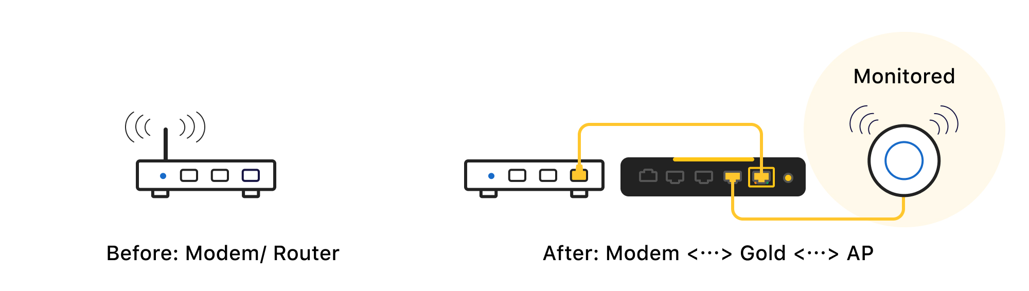

The Firewalla devices seem to be quite flexible and offer multiple different ways to configure and install them (see Which Firewalla mode to use?).
For the Firewalla Gold (FWG), the recommended setup is "Firewalla Router Mode" which is described on the page linked above. The layout is as follows:
In this mode, you should plug the FWG into your existing modem/router, and then plug all LAN devices on your network (including the Mac running SecuritySpy) into the FWG (either directly or via an Ethernet switch). If the FWG is connected to a router, this router should be set to bridge mode. Then, either turn on UPnP in the FWG so that SecuritySpy can automatically configure port forwarding for you, or you set up port forwarding for manually in the FWG.
The downside of this layout is that you can't use the modem/router's built-in WiFi features - this must be provided by a separate access point downstream of the Firewalla.
