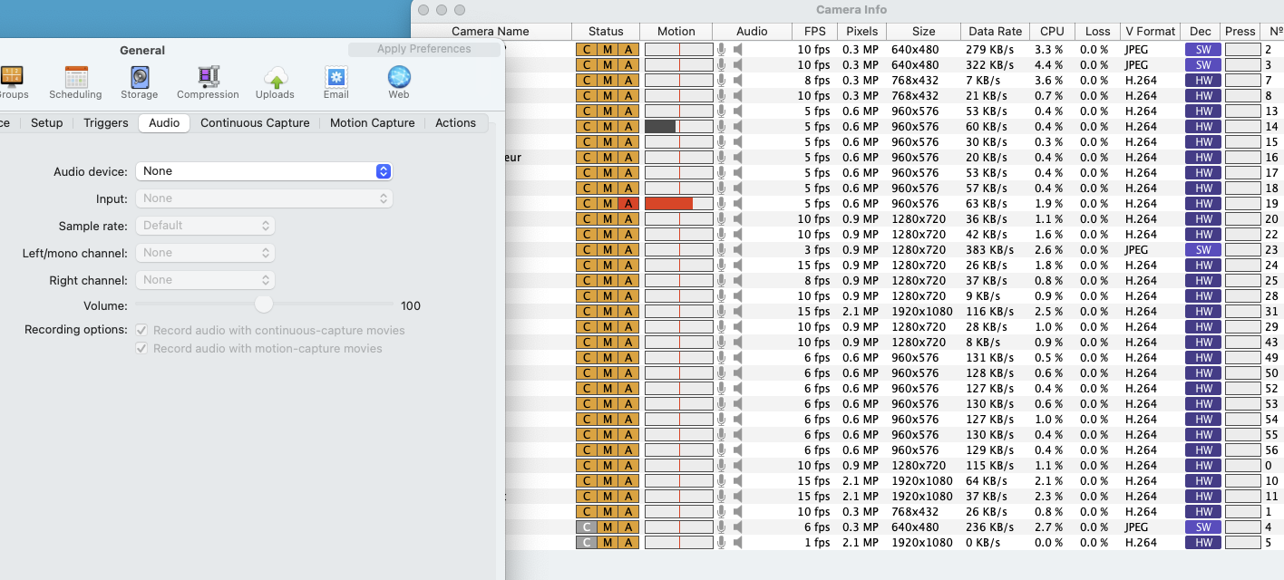

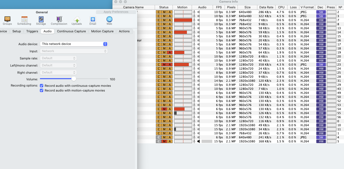

    For me, with only one stream, turning off the audio in sspy reduces the FPS to 1.
    As soon as I enable audio, I get 15 FPS. See the screenshot, the last cam in the info window.
