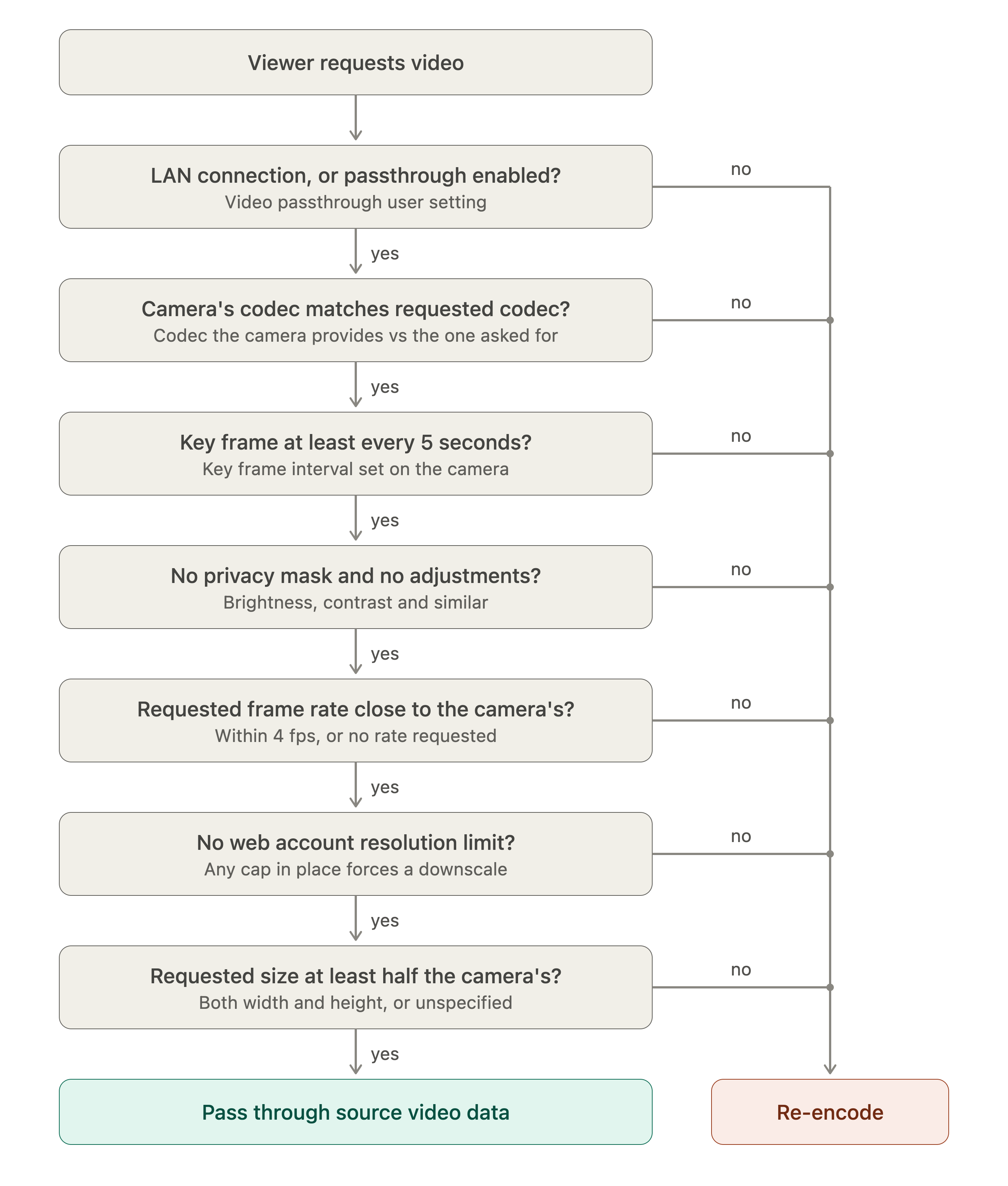

Which of these, if any, is equivalent to an unprocessed (ie, Security Spy is not re-encoding) relay from the cameras?
  • Web streams usually have to be re-encoded, since they aren't necessarily the same resolution, frame rate or codec as the source video.
    But you can obtain a passthrough stream without re-encoding like this:
    • Under Settings > Web > Advanced, enable the option "Pass through H.264/H.265 data".
    • Use RTSP streaming since this is widely compatible with players.
    • When constructing the URL, use "vcodec=h26x", and omit the width, height and fps parameters.
  • Very cool. One addl question. You said use RTSP, but is that required to get the pass-through stream? (I'm building my own player)
  • @Ben Clarification on that followup question, in case it wasn't clear - what I meant was, is acquiring a pass-through stream only possible via RTSP protocol? Does the "vcodec=h26x with no other parameters" trick work with any other protocol SecSpy provides?
    edited July 13
    HTTP Live Streaming always recompresses. This is because it needs a very regular cadence of I-frames in order to manage its internal fixed chunk durations, so the source video data can't be used for it.
    H.264/H.265 over HTTP multipart does respect this passthrough setting, however this is a non-standard streaming format. But, if you prefer it over RTSP, I'd be happy to supply the (relatively simple) details.
    This leaves RTSP as the standard stream for which this setting applies, which is why it was the one I recommended. Will this work for you?
    One other thing I forgot to mention: for passthrough to work, the web account that you are using must not have any account-specific resolution or frame rate limitations. These settings are found when editing web server accounts under Settings > Web.
