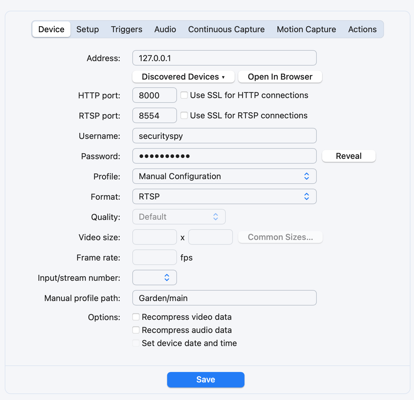

Then I installed GStreamer and the Neolink binary locally on my mac running SS and created a .toml file to configure it to find the Reolink cameras (install the toml file in the same directory as the Neolink binary).
I then created a shell script to run the required command and created a LaunchAgent plist (using https://launched.zerowidth.com/ - which is amazing btw!) to launch it.
Then I updated the SS camera definition to use "Manual configuration", with IP address of 127.0.0.1 and a port of 8554 (you can change this in the toml file but this is what Neolink uses as the default port), then updated the manual profile path accordingly - this is provided by the Neolink binary when you run it in the terminal.
