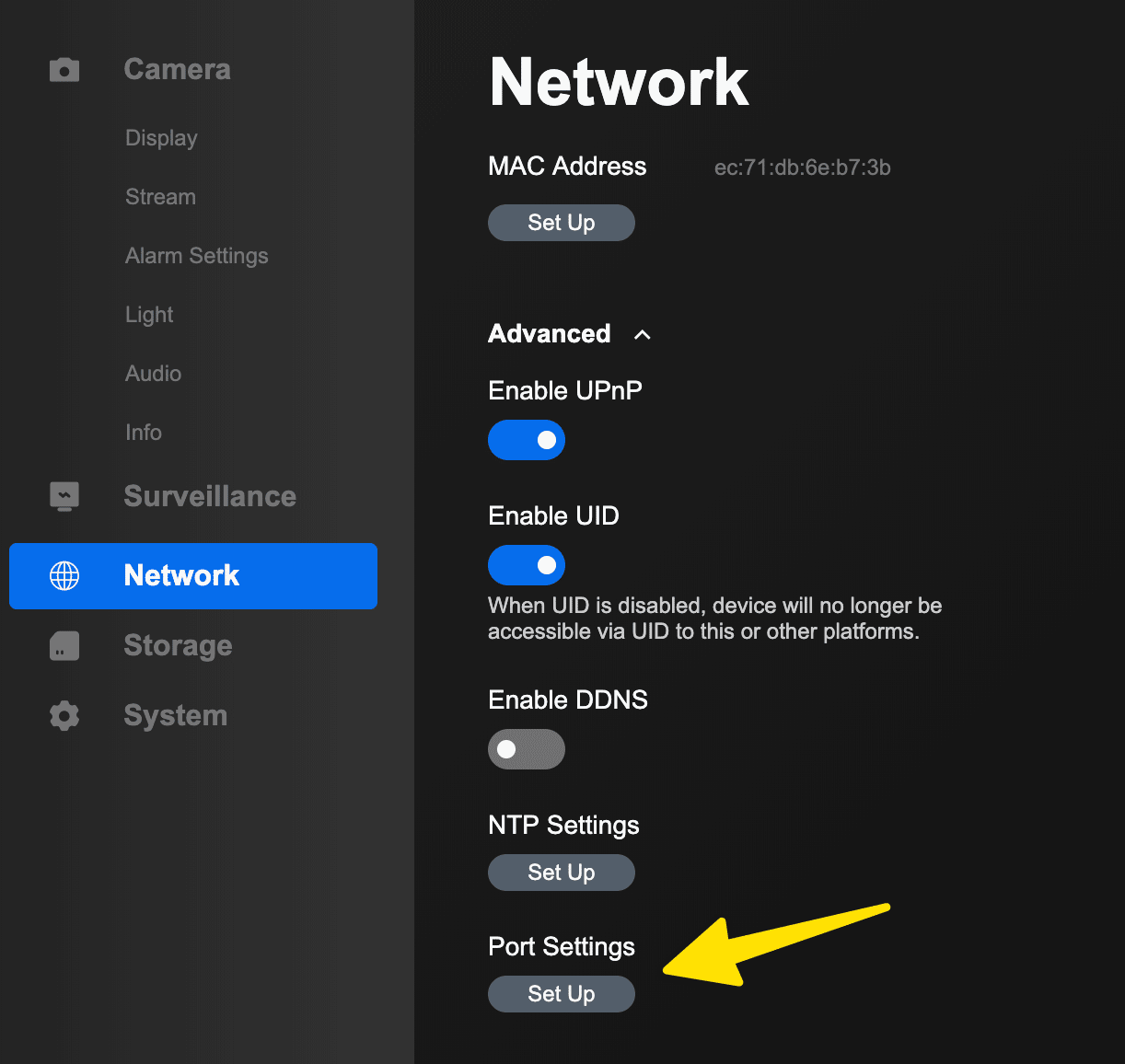

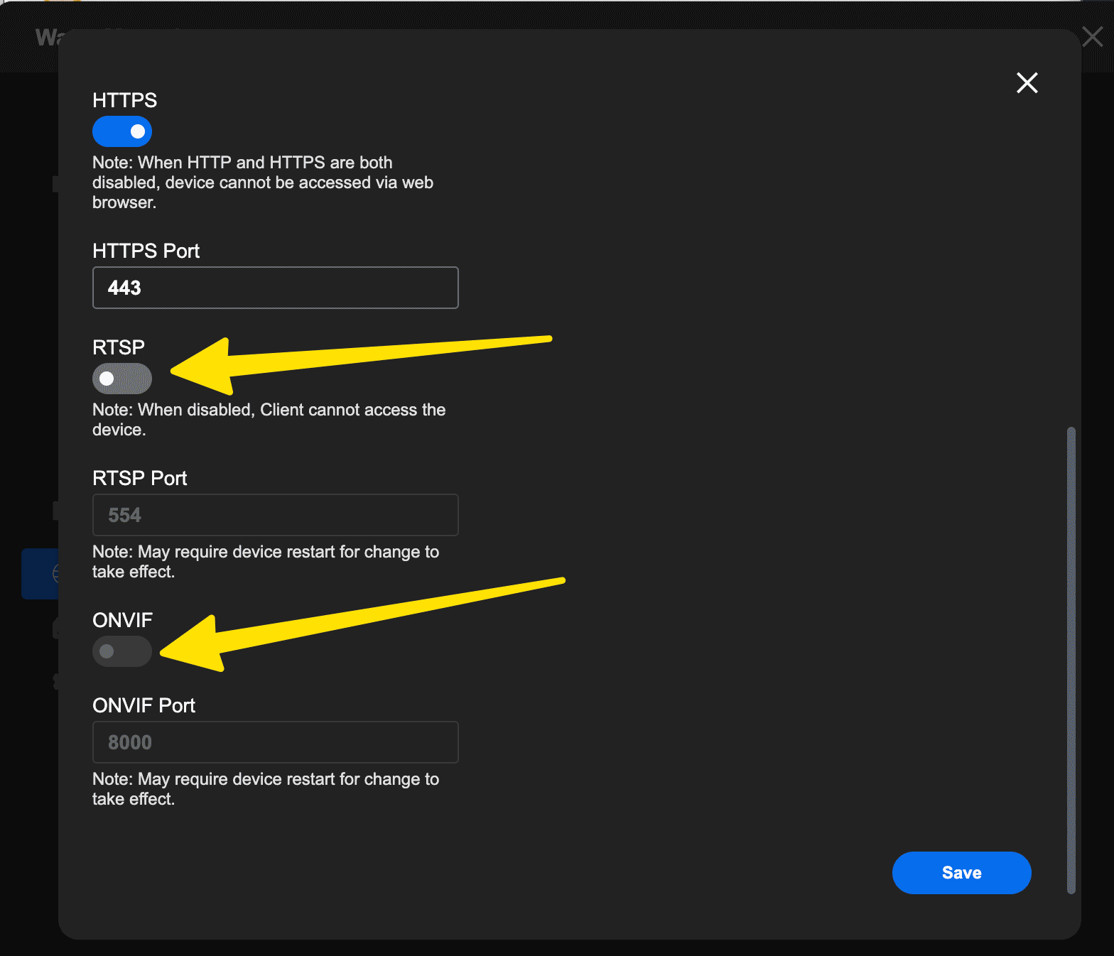

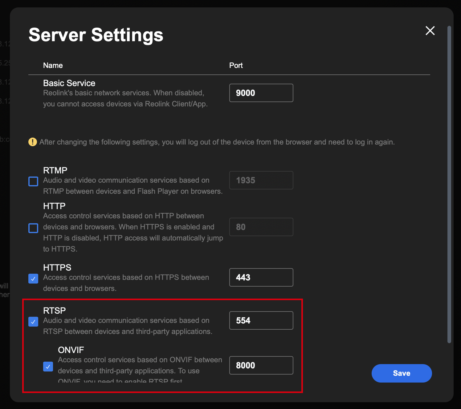

  • Newer Reolink cameras should work just fine in SecuritySpy, but you will have to first enable the "RTSP" and "ONVIF" options. Log on to the camera using a web browser and find and enable these options. They could look something like this:
  • Thanks Ben, that worked just fine
