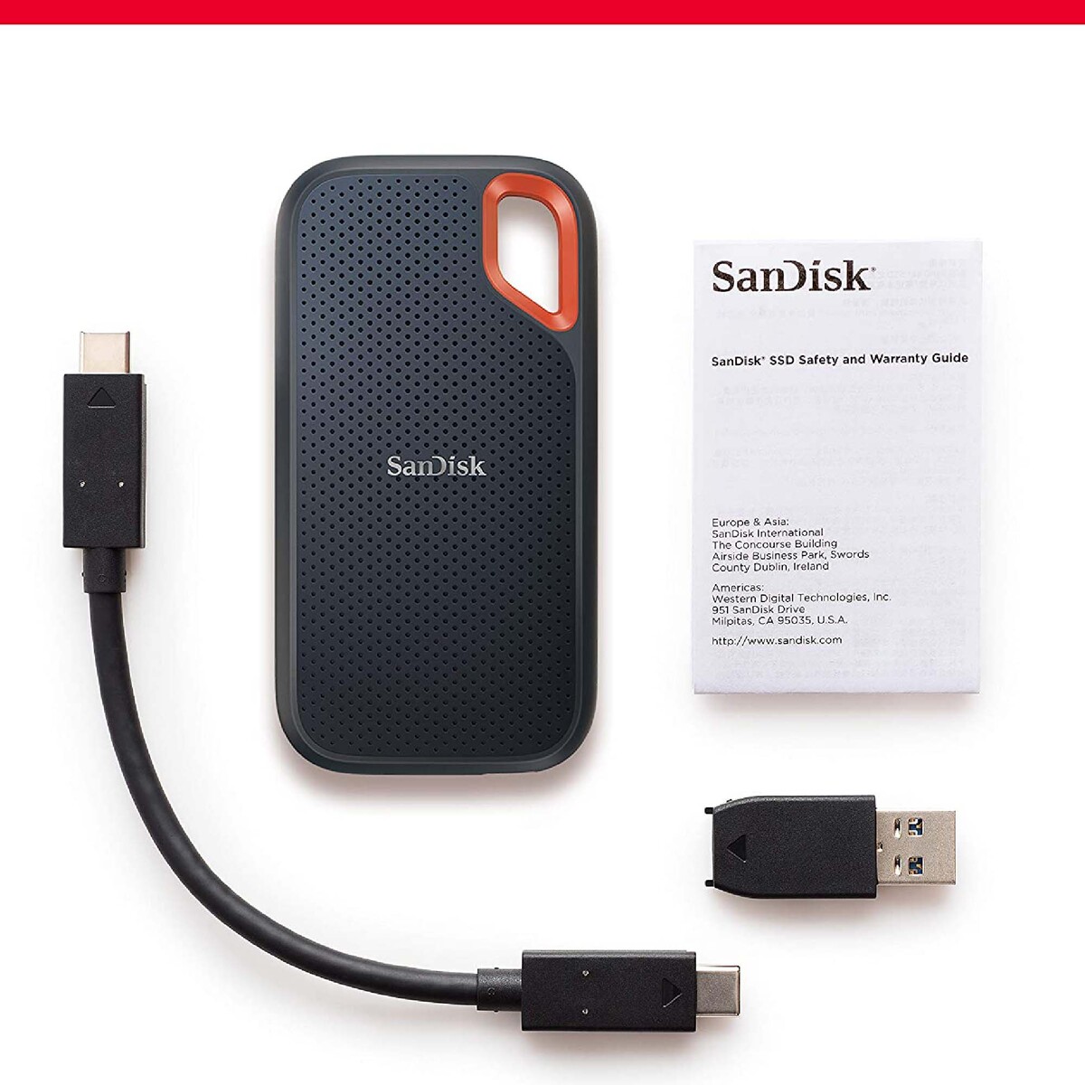

  • What sort of enclosure is it in?

    2. SanDisk Unlocker causing a problem with re-mounting the drive. Might be worth completely removing SanDisk Unlocker https://support-in.wd.com/app/answers/detailweb/a_id/51135/~/steps-to-remove-sandisk-unlocker

    Looks like SanDisk is a little cagey about publishing its TBW specs on this drive, but tech discussions I see online suggest that spec is similar to other competitive drives of the same size, based on the other drives WD has manufactured using the same physical platform.
    It's warranted for 5 years.
