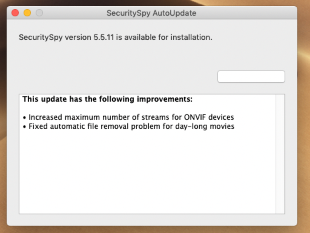

    In the Check for Update option in my current SS v5, I get this:
    I guess that means I need to download and run v6.1 from your site. If I do that, and enter my username and code, will v6.1 automatically find and use my latest settings from v5?
    I think that's what you're saying above, but just want to check first. Thanks again!
  • Hi @citysnaps, thanks for purchasing! The updater in SecuritySpy 5 will first offer you any available version 5 updates. Once you are on the latest v5 version (which is currently v5.5.11), it will then offer to install version 6 for you.
    Alternatively, you can download and install version 6 manually from the SecuritySpy download page.
    When you install version 6, it will pull in all settings from version 5, and should also automatically register itself with your new v6 license.
