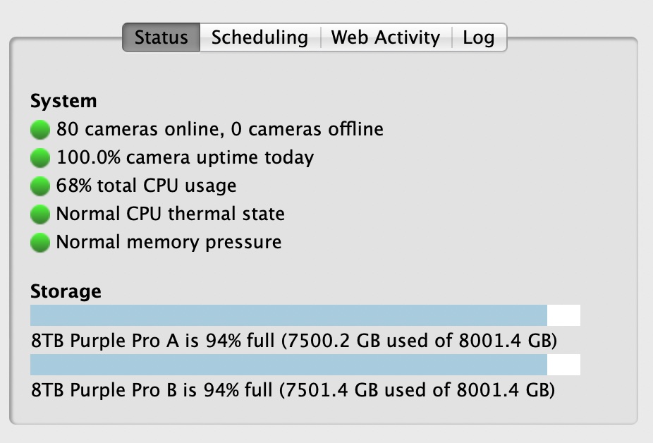

  • I have had a much different experience. I have 80 cameras running on one M1 Mini. The mini has 8GB of ram, and this has never been a problem. Ram usage runs about 1.5GB. I am not using precapture, recompression, or advanced motion detection. The cameras are all 1080p, 15fps, and streaming h.265 at around 2-4 mbps VBR. Half of these cameras are set to motion record and the other half are continuously recording. The hard drives are 8TB Western Digital Purple Pro drives formatted as APFS. The pro is very important, as these 7200rpm drives are faster than regular purples. I had a bit of trouble at first until I evenly distributed the decoding of the cameras between hardware and software in the camera info window. The Mac Mini is connected to the network via it's built-in 1GbE port. The main display is set to 1080p. The secondary display runs at 4k, and displays all cameras constantly. I have experienced Zero Memory pressure, Zero Network pressure, Zero Decoder pressure, Zero CPU pressure, Zero Thermal pressure, and Zero downtime over a two year period. Rock and Roll.
