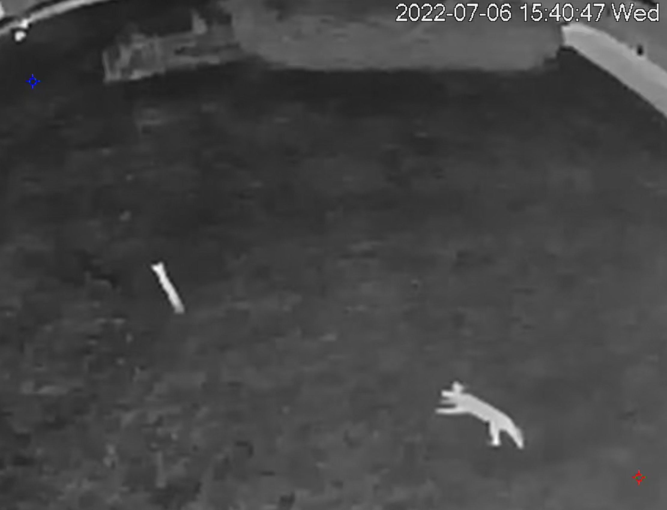

I am using thermal cameras. They will produce two feeds, one thermal, and one visible. Animals and people produce very defined images on the thermal as shown in the post above and the images below. I wonder if the thermal channel could be used to trigger the SS motion detection, being able to leverage the AI to discern differences between animals, cars and people. This channel could then be set to trigger the visible camera stream recording as well as other actions. Think of it as as Intelligent PIR. Regular PIR does not work well outdoors because it does not know the difference between people and pets. I plan on putting this idea to the test in the near future.
The attached images show Foxes playing in my front yard. One is a juvenile fox. In the video they roll around on the grass and play.

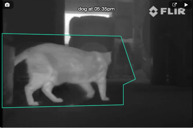

At the moment I'm running a a FLIR II "Marine" that I got lucky enough a few years ago to get at a bargain (relatively...) from a boat builder on the east coast. It's a 320x240 res. the PTZ board stopped working way out of warranty, but the IR cam inside the housing works well, so it's now a "stationary" cam. Also own a Flir E8 for general "techie" stuff of all sorts. FLIR imagers are still very expensive, and the lenses are usually made of Germanium, which can pass the long wave IR. Here's a pic of a "Kitah"....
