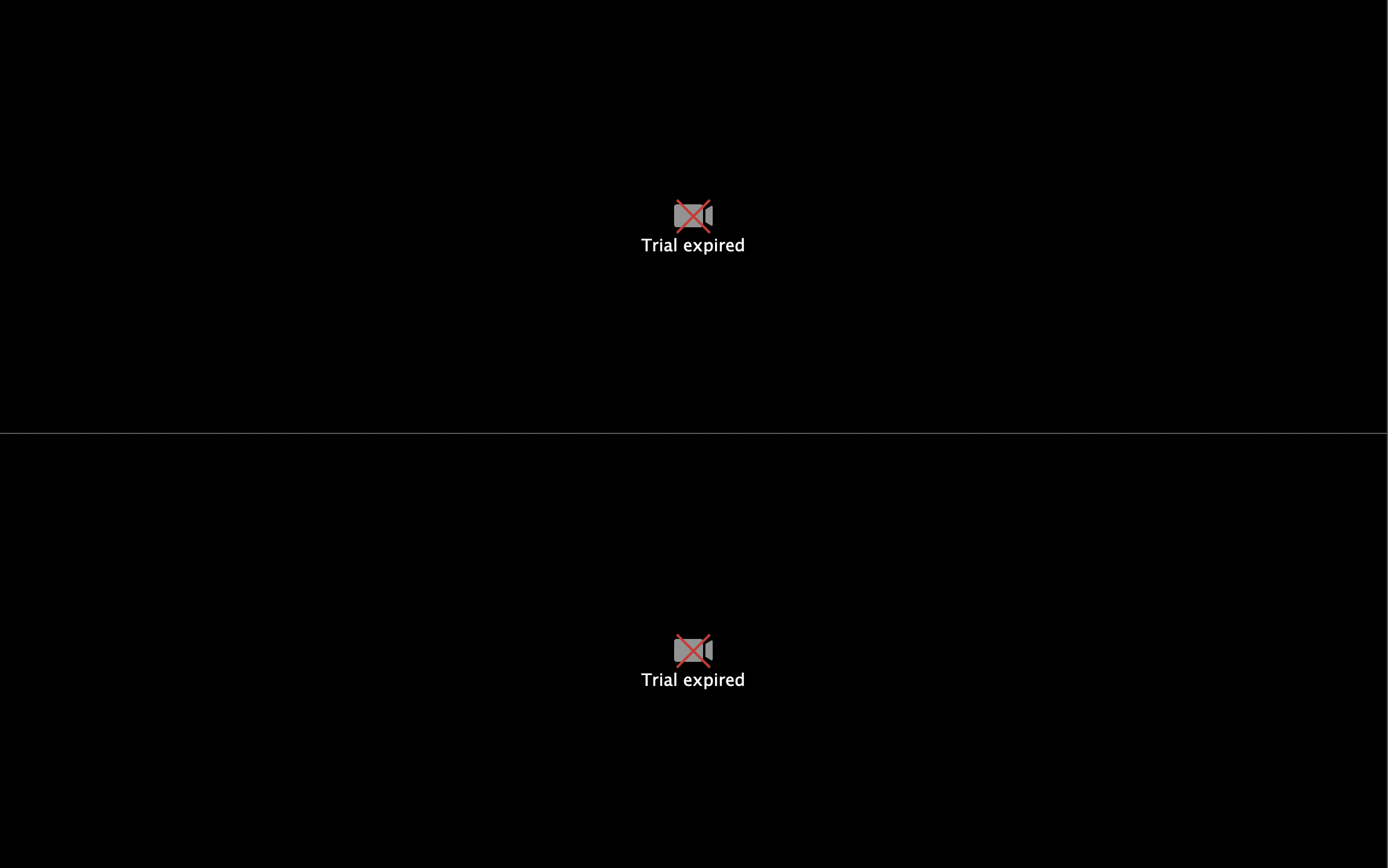

  • I am trying to view cameras on a second installation, the cameras initially show up on my screen but then after a couple of seconds go away and "trial expired" is shown.
    Are we still able to use a second installation on a second computer to view cameras?

  • Yes, it is still possible to use additional (free, unlicensed) instances of SecuritySpy on other Macs for the purpose of viewing your main (paid, registered) SecuritySpy server. Just make sure these viewing instances are configured to pull the feeds from the server, not directly from the cameras themselves. Instructions are here: SecuritySpy as Remote Viewing Software.

    Thanks Ben, adding the cameras via the server worked great.
